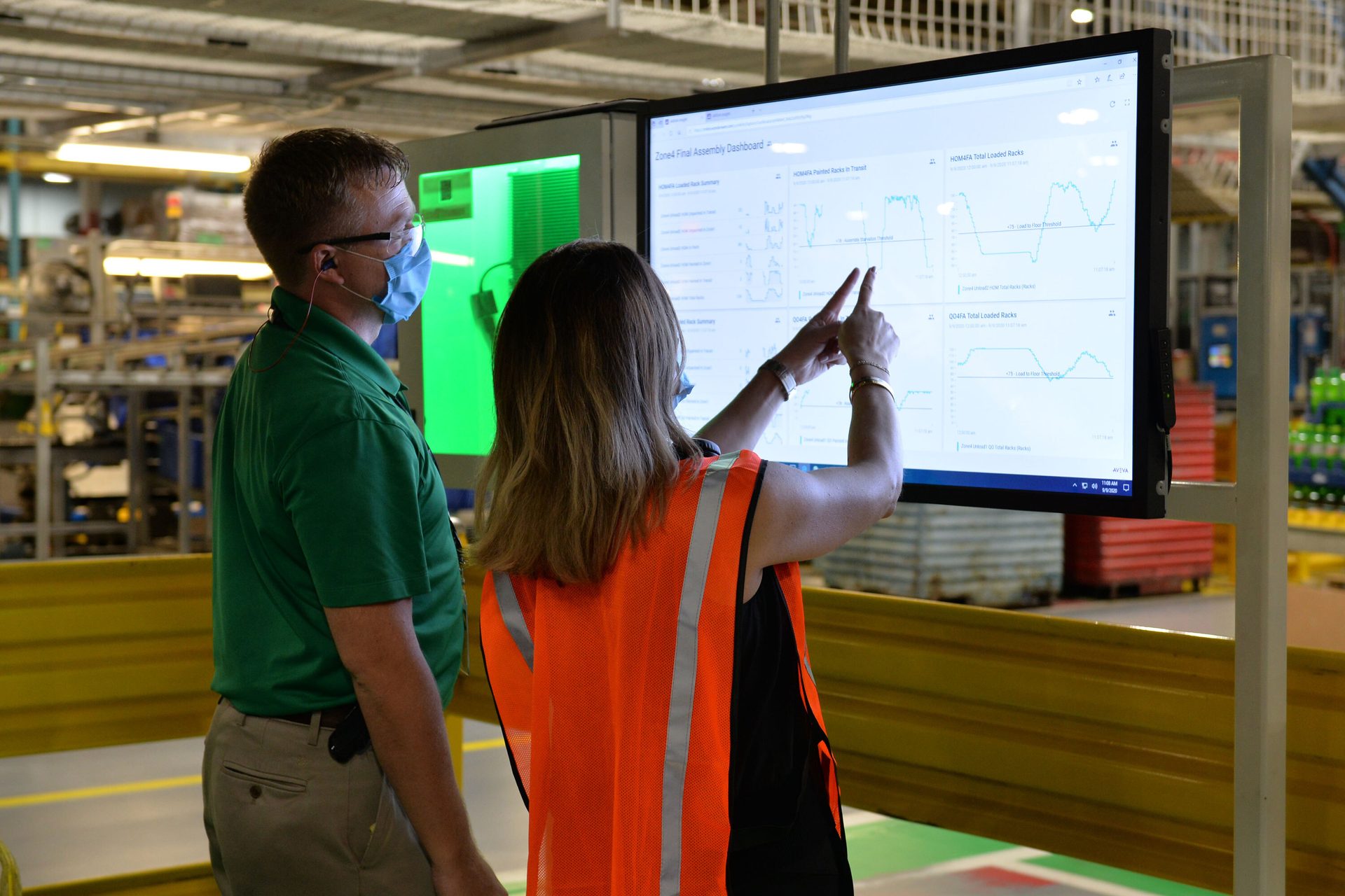

Schneider Electric Lexington has digitized the entire continuous improvement process. Photo courtesy Schneider Electric

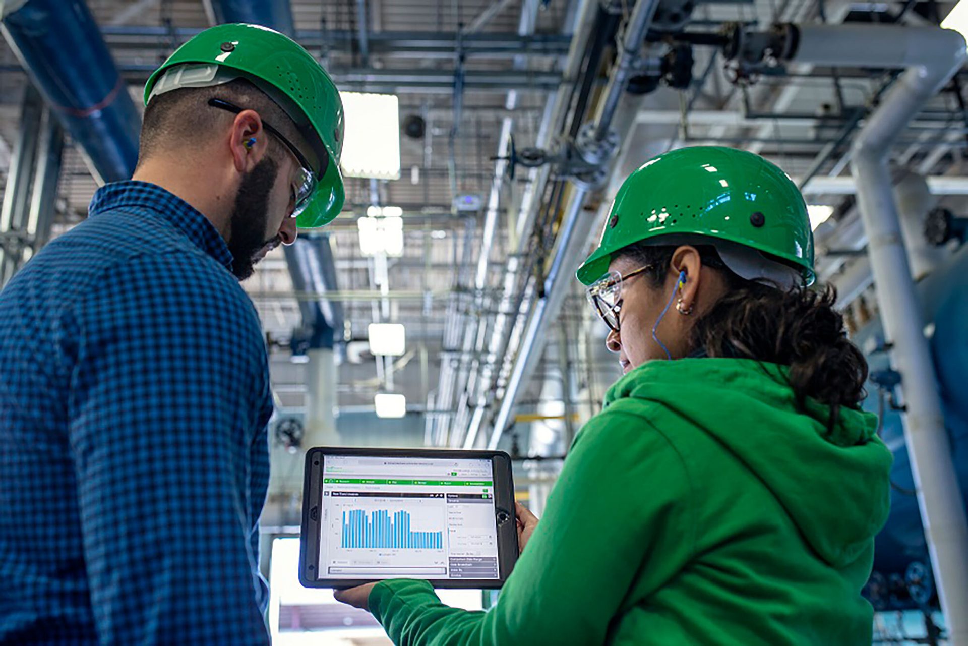

Upgrades enabled by digitization and connectivity have improved operational efficiency and mean time between failures. Photo courtesy Schneider Electric

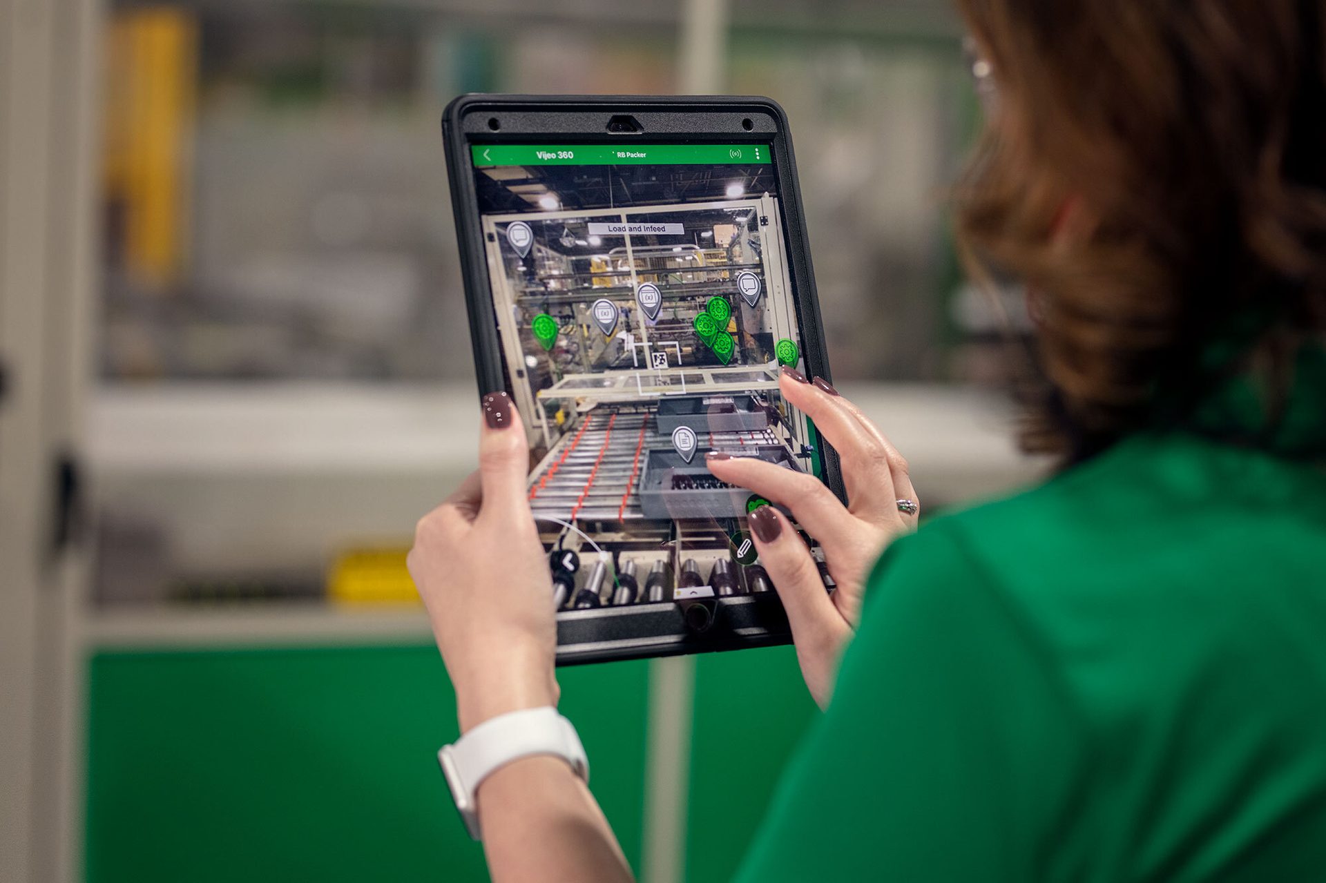

Because production equipment is connected, employees can monitor energy usage and perform a variety of diagnostic and predictive maintenance tasks. Photo courtesy Schneider Electric
The Lexington plant harnesses Schneider Electric’s Industrial Internet of Things (IIoT) based EcoStruxure system, which provides digital tools such as augmented reality, remote monitoring and predictive maintenance to drive energy efficiency, sustainability and overall cost savings.

Today, the Lexington plant continues to drive efficiencies and establish new smart factory benchmarks. For instance, monitoring and analyzing energy usage has driven a large annual savings.
“Our smart factory program has developed standards for machine learning and IoT technology,” explains Labhart. “We have deployed platforms and infrastructure to support data streaming of critical signals from equipment, such as pressure, temperature and vibration. We currently have nearly 3,000 signals that are streaming from the factory floor. We use that data for visualization and to detect anomalies in production operations.
“We have also digitized the entire continuous improvement process,” Labhart points out. “Our lean digitization system has eliminated the use of boards and markers, which were commonly used to communicate back in 2007.
“It collects and calculates performance data, creates digital reports and delivers digital andon information to the factory floor that goes out through mobile devices,” says Labhart. “Another tool gives us the ability to manage the resources and the actions associated with continuous improvement.
