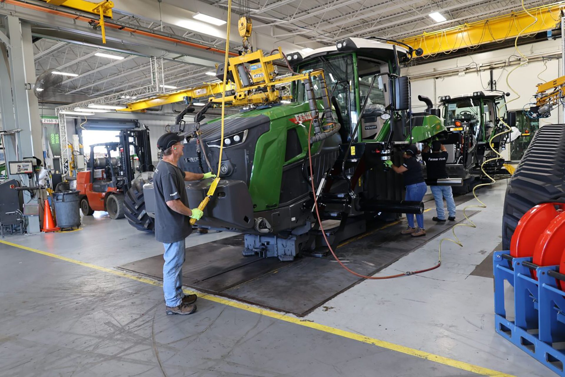

All tractors on the Jackson assembly line are now painted green and equipped with tracks. Photo courtesy AGCO Corp.

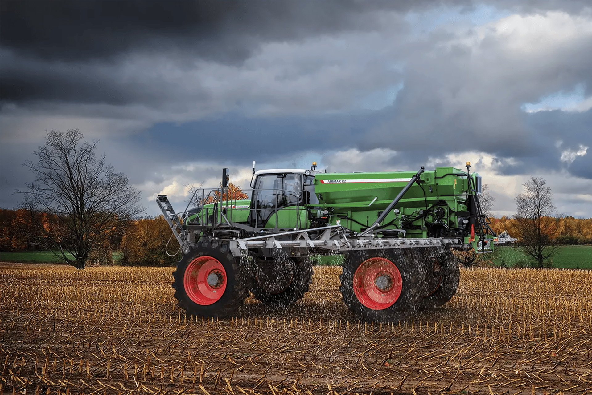

“In 2022, we launched the Fendt Rogator 900, the world’s first self-propelled row-crop sprayer that features adjustable height,” says Van Genderen. “The entire suspension system on the four-wheeled machine raises and lowers based on the crop height. Because the product is revolutionary, we had to make a lot of changes in our assembly line to accommodate it.

“We’ve gone through a lot of changes here, but not as much on the manufacturing side of operations,” explains Van Genderen. “We have not made any major changes to our production line. However, we did upgrade some test equipment and subassembly manufacturing processes.”
The Jackson facility has invested in its tube fabrication department, which produces large steel booms for the Rogator. The extendable booms come in 90-, 100- and 120-foot lengths with 10-, 15- and 20-inch nozzle spacing to suit specific width, volume and broadcast needs of farmers.
“We recently purchased a state-of-the-art laser welding and material handling system, including an advanced robotic cell,” says Van Genderen. “That has enabled us to vertically integrate more tubing production in-house.

This row crop sprayer features a height-adjustable suspension system. Photo courtesy AGCO Corp.

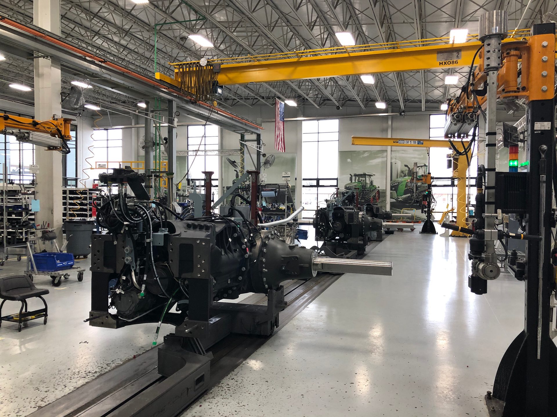

To address ergonomic concerns, such as strains, pains or exertion issues, the Jackson plant employs a part-time chiropractor and a full-time physical therapist. Photo courtesy AGCO Corp.
“So far, the initiative has been very successful,” claims Van Genderen. “We have hired a large number of Spanish-speaking employees. But, we had to develop and build systems to support that shift in direction. Our bilingual efforts have included translation, training and mentorship programs.”
To address ergonomic concerns, such as strains, pains or exertion issues, the plant still employs a part-time chiropractor and a full-time physical therapist. Within the last two years, it has also added two part-time behavioral health specialists to address mental well-being.

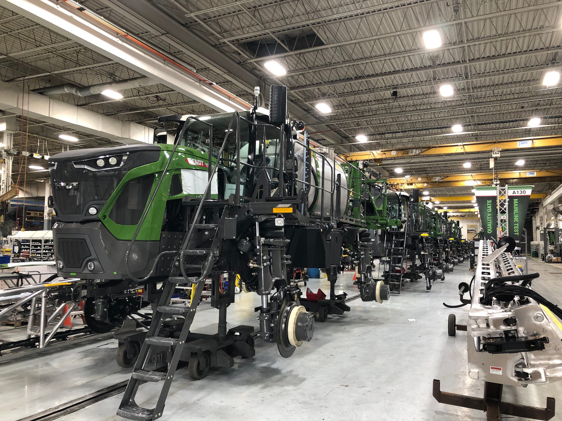

All Jackson-built tractors are now made on Fendt power trains and module platforms. Photo courtesy AGCO Corp.
